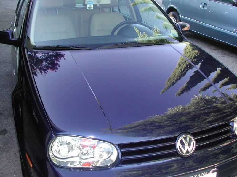

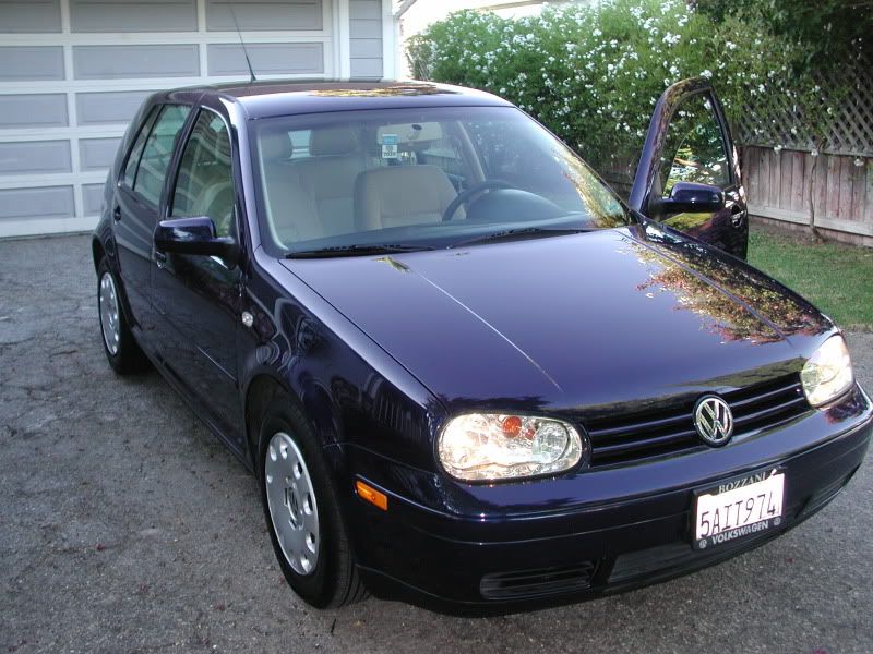

    It been a while that i have write up with recent project
    This Golf have been treated by me 1 and a half year ago, and the owner was amaze what a transformation it can be done. So, recently she asked me to detail her car, and upon closer inspection, the condition of the car was great, even after almost 2 years since last detail.
    This car have very low miles on it , it only have 58K, all this years.
    After talked with the owner, she have booked for 2 day intensive detail, and she delivered the car to me on 9:00am , and she even got me a nice breakfast.
    The car been washed with car wash that have self-damage brushes..but not so major. It just been taking care of by SIP

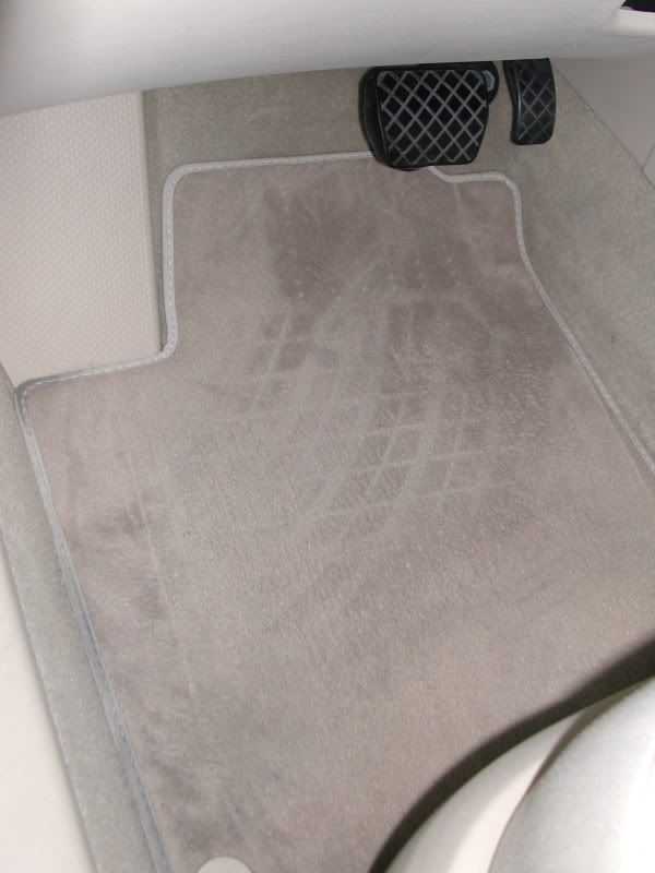

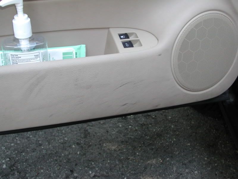

    After i recieved the car, i did a clean-out of owner's personal belongings. remove the floor mats , and apply the Liquid Clay, and after head to self car wash with a high pressure hose and DI water at the end.
    The clay stuff actually work so well..i just rinise the car..it feel great already,but don;t let this stuff sits..otherwise you will have a fun time of removing it.

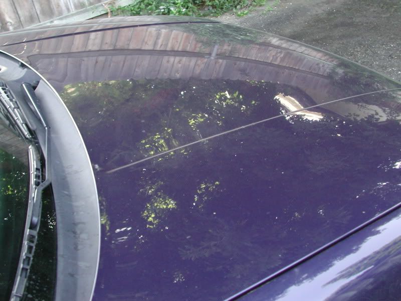

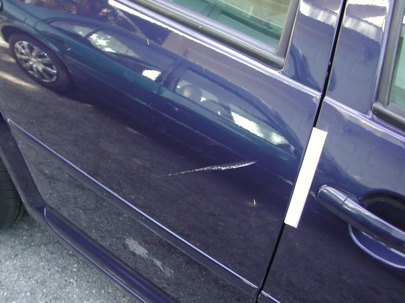

    After drying the car with absober towel, and drying blade, all the swirls is shown..and i already got idea how to knock it off.

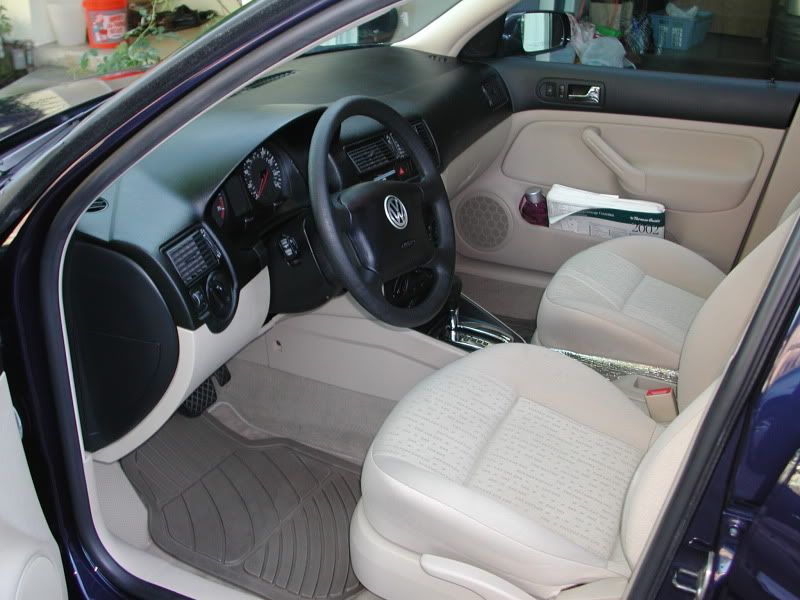

    than, i continue to polish the exterior, while my helper start to vacum the interior, and he cleaned the mats, seats, and carpet, and i contiune to polish the exterior with different wax.
    Well..we progressed very well day 1..and day2 just to follow up with more wax and cleaning to the area that needed attention.
    Sorry not so much before picture, as i am working alone.

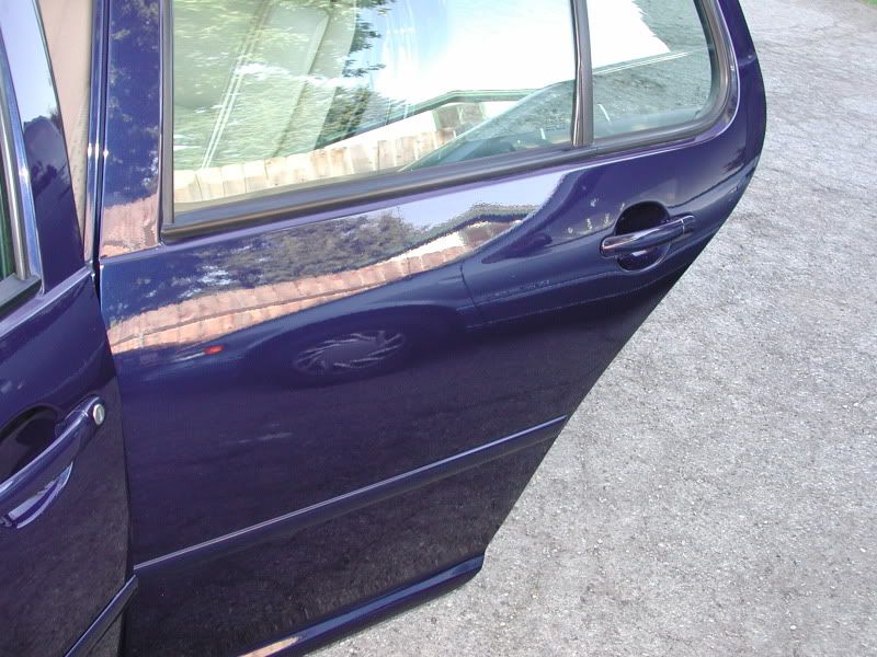

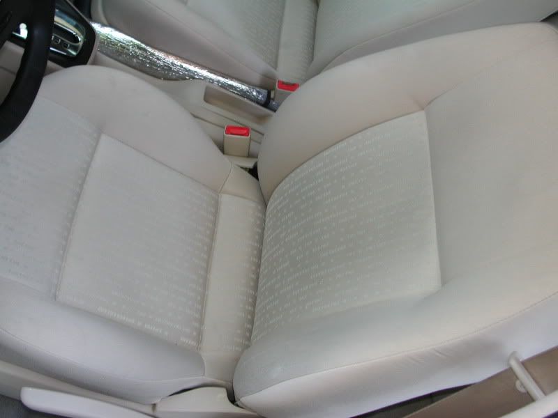

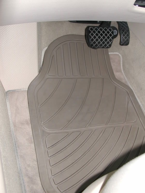

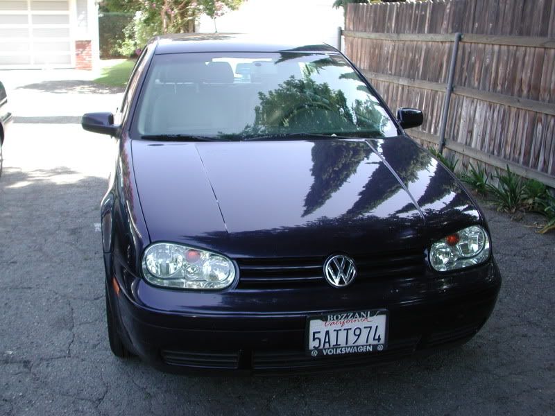

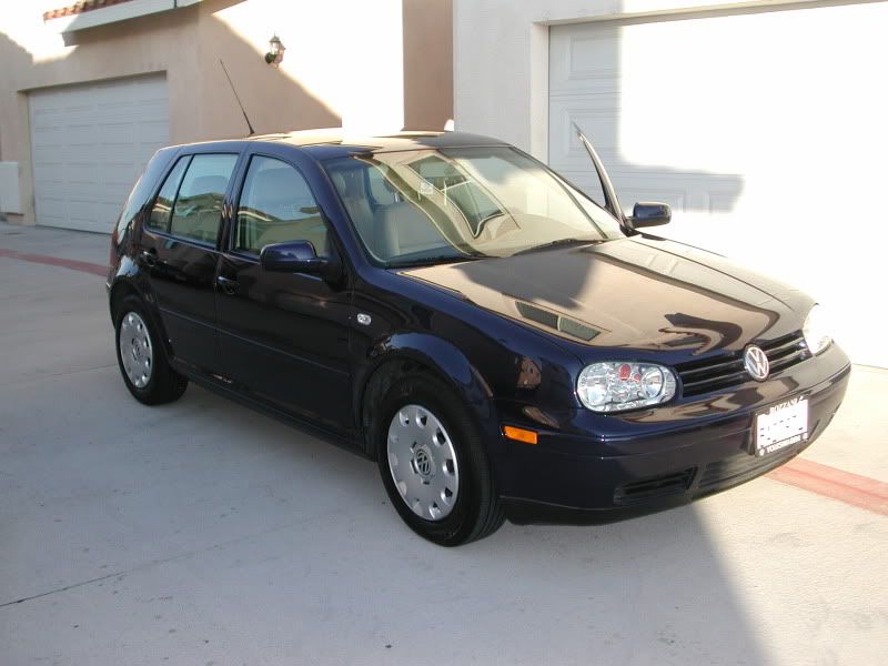

    Let the picture communicate with you.
    Wash
    Egale One Car Wash
    Turtle Wax Liquid Clay
    Dry with Water Blade & The Absober Mini
    Wheels
    Swissvax Wheel Brush
    Purple Power APC
    Turtle Wax Wet and Shine for dressing
    Paint
    Clay with Mothers Yellow Clay(not so impress)
    Mothers Quick Finish as lube (not so impress)
    Use Megiars Swril'X (This Works Great on dark color car)
    Use SIP
    Zymol Cleaner Wax (This product is bang for your buck!, it add so much oil to your paint)
    Topped with Meguiar's Polish
    LSP
    P21S Blue Top 3X
    Trim
    Mothers Black to Black on Plastics
    Mothers Chrome Polish on Chrome and Grill
    Wipe down with APC
    Sorry not much Before Picture, as i am rushing to finish as much as i can before 7:30
    Before
    Interior
    After
    Thanks for watching..Welcome for comments
